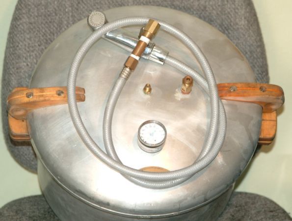

The Mark 1 Navy Shower System (suitable for Marine use though).
Fill with 16 quarts of H20. Heat to desired temperature. Install lid. Pressurize with compressed air. Get wet. Lather up. Rinse off. Done!
Also it is big enough to double as a wash basin for dishes and if the water gets cold you just put it on a burner to heat it right back up.

Postby eamarquardt » Wed Mar 02, 2011 10:13 pm
The pressure cooker is designed to run at 15psi. I took out the rubber safety plug and installed an industrial pressure relief valve set to 15 psi, a schrader valve to pressurize it, a pressure gauge, and a dip tube so you pull the water from the bottom of the cooker. As I recall it costs about $25 bucks in parts to do it right. I weld up the lid a bit where I drill and tap the extra holes.
I got my pressure cooker at a garage sale for $5. They are also available on EBay.
If you get the lid to me , I can modify it for you.

Thanks Gus...so at 15psi...do you get a good spray? Just wondering about the lift on the hose. Does it need a re-pump to run out all the water? Doug

Gus! they called me crazy on here last winter. But I built your pressure cooker hot water heator this last christmas!
all I need to do now is test the thing out to see how great it works.
I was even told the thing would blow up on me by some folks on here.
Wacko! I know. but some day before the camping season kicks in the end of may in wyoming
I am going to get off my lazy butt and test my pressure cooker hot water heator out.
I used a pressure cooker with handles on the lids. srew handles.
I did a bit of mods to my sipon tube out of the bottom of the pot and trew the lid.
I drilled a hole in the lid with my drill press for the kitchen faucet hose
I taped that with treads with a 1/4 tap and put in a brass fitting to go from the copper line in side my pressure cooker pot to the lid. the treads stuck out on the brass fitting and that got my L treaded on and that was what i treaded my kitchen hose to.
I put in a fitting from a old air compersor on mine that I can let off the pressure with a pop off valve.
you say a bike pump will pump it up. have you used the manual ones to get the 15 pounds on your pressure cooker before?
I am conseredering geting a cheapo 12 volt cigerate lighter one to pump mine up and pluging it into my teardrop's 12 volt outlet in the galley.
Slowcowboy. I got one of these pressure cooker hot water heators built and ready to go!!!!!!!!!!
