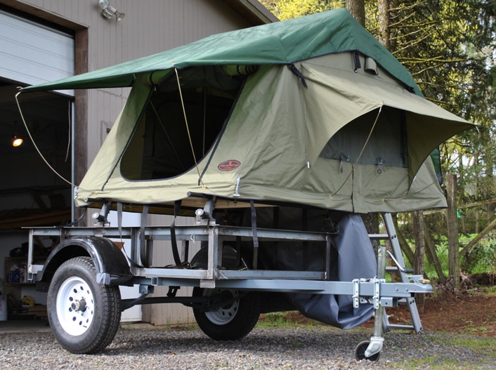

Guy, Multi-purpose and softsided, that's a great approach to a lightweight camping trailer. Here is one I'm working on that uses a self-contained folding tent unit.
Scott
Camping the "Compact Way"
